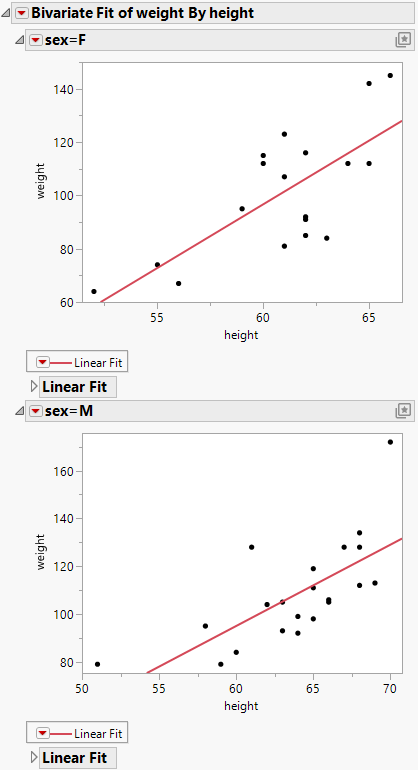

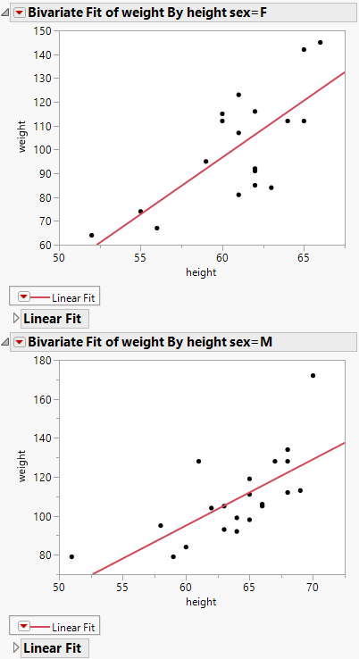

Figure 5.21 Example of By Variable PlotsĀ
There are separate analyses for each level of the By variable (sex). You see a scatterplot for the females and a scatterplot for the males.
