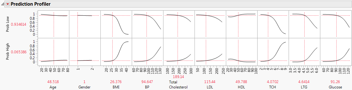

7. Click the Naive Bayes red triangle and select Profiler.
Figure 8.3 Prediction Profiler for Disease Progression

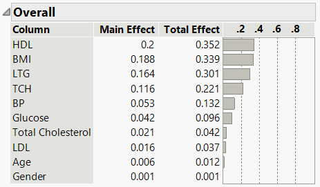

8. Click the Prediction Profiler red triangle and select Assess Variable Importance > Independent Uniform Inputs.
Figure 8.4 Variable Importance
Variable Importance
The Summary Report indicates that HDL, BMI, and LTG have the greatest impact on the estimated probabilities.

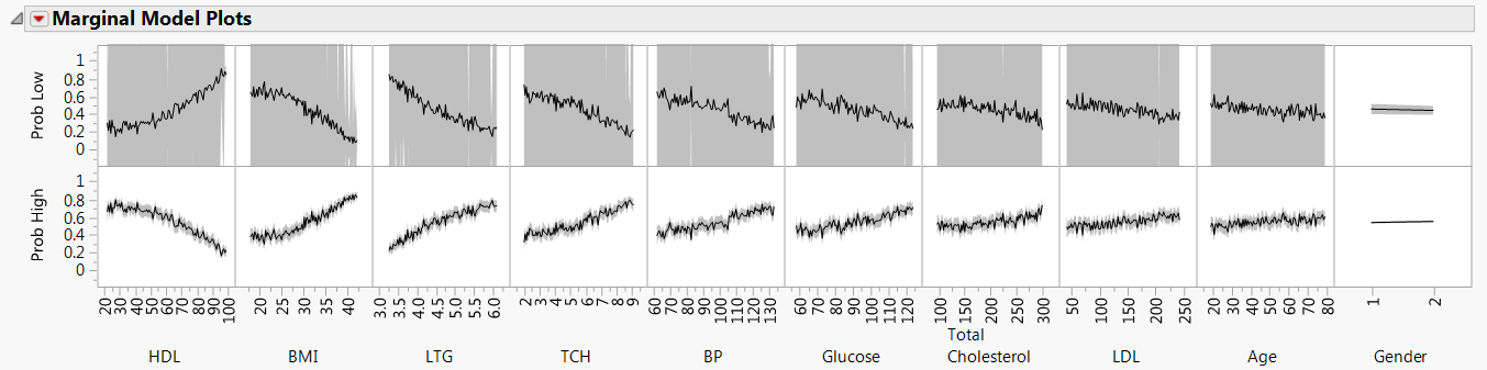

Figure 8.5 Marginal Model Plots Report
The second row of plots in the Marginal Model Plots report shows that higher values of HDL are associated with a lower probability of classifying a patient as High. Also, higher BMI and LTG values are associated with a higher probability of classifying a patient as High.
