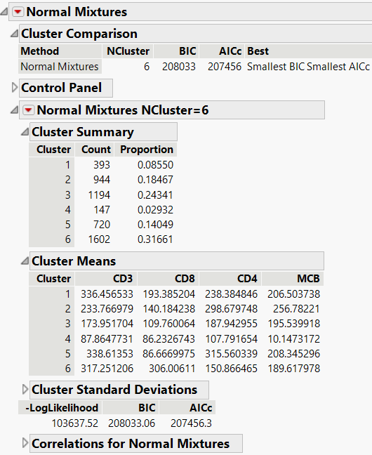

Figure 15.2 Normal Mixtures NCluster=6 Report
The Cluster Summary report shows the number of observations in each of the six clusters. The Cluster Means report shows the means of the four marker readings for each cluster.

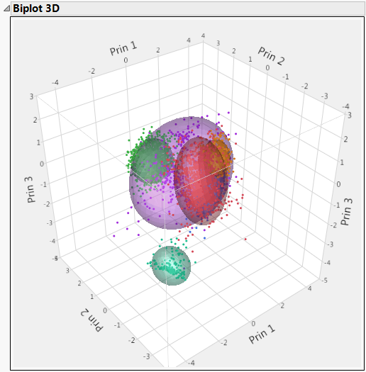

7. Click the red triangle next to Normal Mixtures NCluster=6 and select Biplot 3D.
Note: Your biplot 3D might appear differently because the algorithm has a random starting value.
Figure 15.3 3D Biplot of Cytometry Data
The plot shows contours for the normal densities that are fit to the clusters. Note that one cluster appears to be distinctly separated from the other clusters based on the first three principal components.
