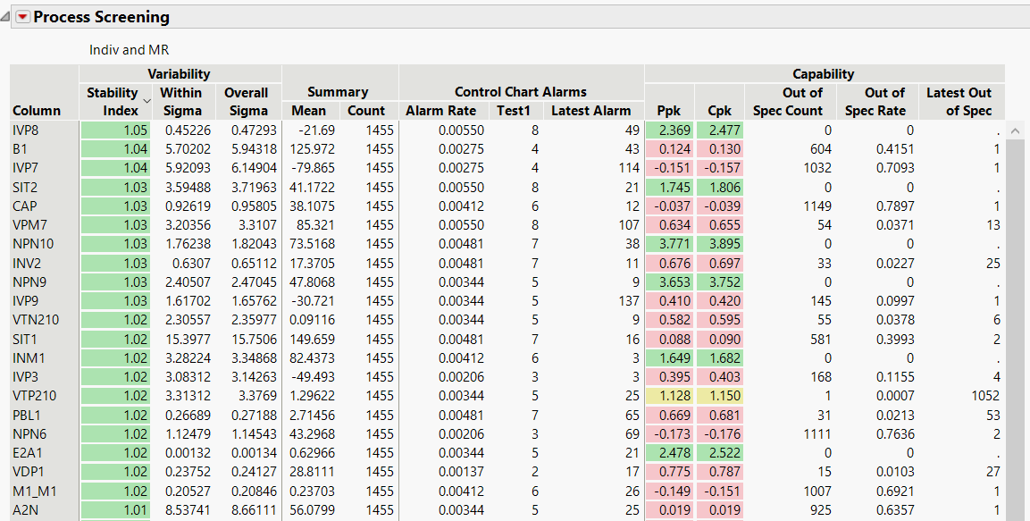

Notice that the Control Chart Type is set to Indiv and MR.
7. Click OK.
Figure 8.2 Partial View of Initial Report
The Process Screening window appears, showing a table of results for each process. The table is sorted by Stability Index. This is a measure of the stability of a process, where a stable process has a stability index near 1. Higher values of the stability index indicate a less stable process. (The sorting is indicated by the caret beside Stability Index in the report.) You want to take a closer look at processes with a stability index value greater than or equal to 1.03.

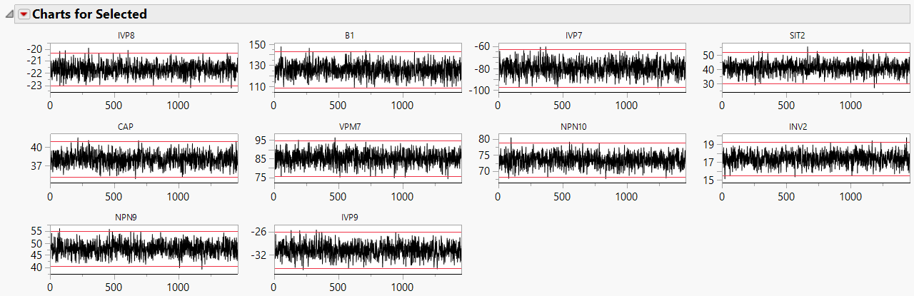

8. In the report window, select processes IVP8 through IVP9.
Each of these first 10 processes has a value of 1.03 or larger in the Stability Index column.
9. Right-click the selected processes and select Show Charts for Selected.
Figure 8.3 Charts for Highest Alarm Rate Processes

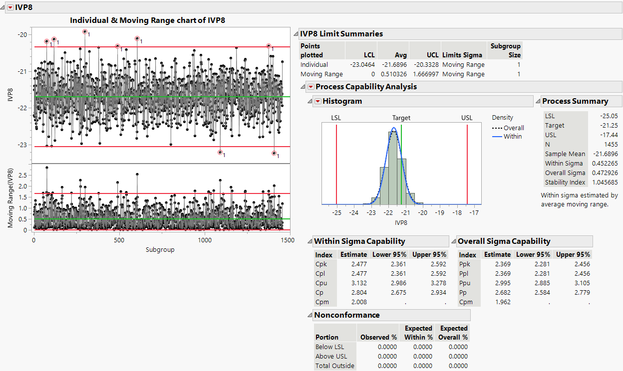

You decide to take a closer look at IVP8 (row 1, column 1 in the Charts for Selected).
10. Select the first process in the Summary table, which corresponds to IVP8.
11. Right-click the selected process and select Control Charts for Selected Items.
Figure 8.4 Control Chart Builder Report for IVP8
A Control Chart Builder report appears. Because IVP8 has a Spec Limits column property, the report also includes a capability analysis.
