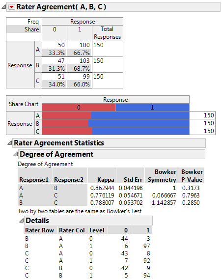

Use the Categorical platform to summarize data from multiple raters. In the data, each column contains ratings for a single rater.
1. Select Help > Sample Data Folder and open Attribute Gauge.jmp.
3. Select the Related tab.
4. Select A, B, and C, and click Rater Agreement on the Related tab.
5. Click OK.
Figure 3.33 Rater Agreement ReportĀ
