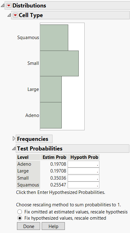

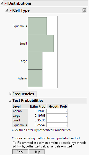

1. Select Help > Sample Data Folder and open VA Lung Cancer.jmp.
3. Select Cell Type and click Y, Columns.
4. Click OK.
5. Click the Cell Type red triangle and select Test Probabilities.
Figure 3.17 Test Probabilities Report Options for a Variable with More Than Two LevelsĀ
Generate the Test Probabilities Report
To generate a test probabilities report for a variable with more than two levels:
1. Type 0.25 in all four Hypoth Prob fields.
2. Select Fix hypothesized values, rescale omitted.
3. Click Done.

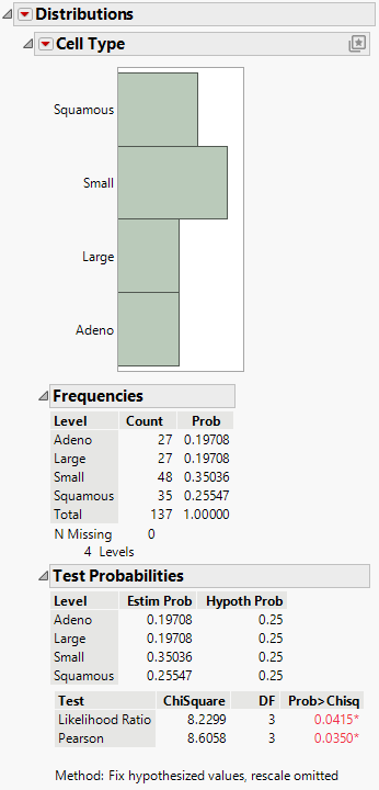

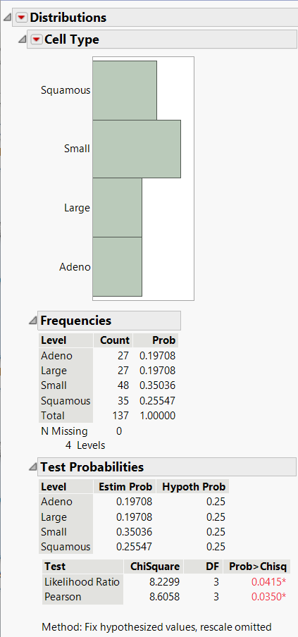

Likelihood Ratio and Pearson Chi-square tests are calculated.
Figure 3.18 Test Probabilities Reports for a Variable with More Than Two LevelsĀ
