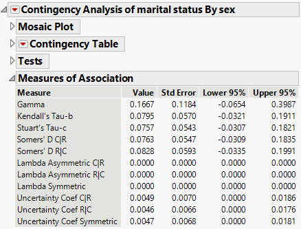

6. Click the Contingency Analysis red triangle menu and select Measures of Association.

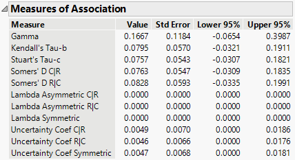

Figure 7.15 Example of the Measures of Association ReportĀ
Since the variables that you want to examine (sex and marital status) are nominal, use the Lambda and Uncertainty measures. All of them are small, so it seems that there is a weak association between sex and marital status.
