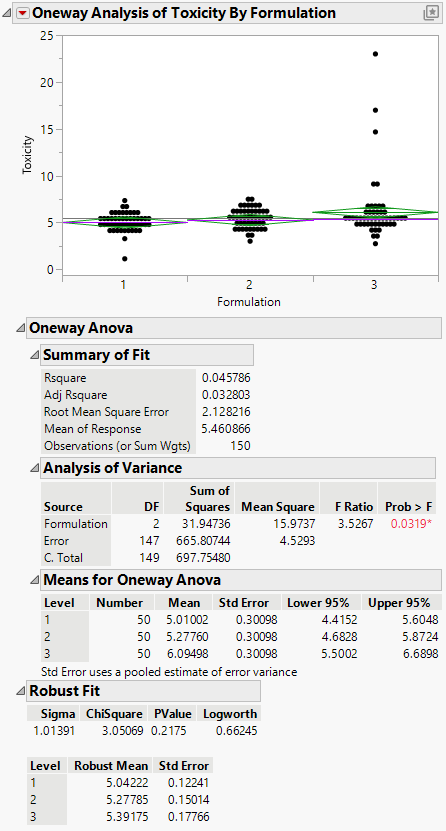

Use the Oneway platform with a robust fit in this example where one of three groups contains outliers. The data contain the toxicity levels for three different formulations of a drug.
1. Select Help > Sample Data Folder and open Drug Toxicity.jmp.
3. Select Toxicity and click Y, Response.
4. Select Formulation and click X, Factor.
5. Click OK.
6. Click the Oneway Analysis red triangle menu and select Means/Anova.
7. Click the Oneway Analysis red triangle menu and select Robust > Robust Fit.
Figure 6.28 Example of Robust FitĀ
If you look at the standard Analysis of Variance report, you might conclude that there is a difference between the three formulations, since the p-value is 0.0319. However, when you look at the Robust Fit report, you would not conclude that the three formulations are significantly different, because the p-value there is 0.2175. It appears that the toxicity for a few of the observations is unusually high, creating the undue influence on the data.
