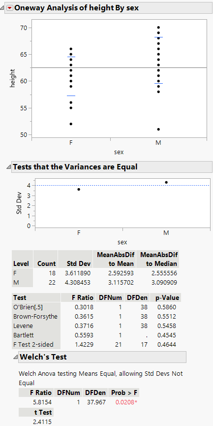

Use the Oneway platform to test whether two groups have equal variance.
3. Select height and click Y, Response.
4. Select sex and click X, Factor.
5. Click OK.
6. Click the Oneway Analysis red triangle menu and select Unequal Variances.
Figure 6.25 Example of the Unequal Variances ReportĀ
Since the p-value from the 2-sided F Test is large, you cannot conclude that the variances are unequal.
