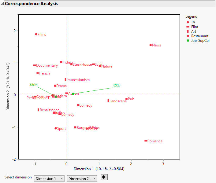

Figure 7.6 MCA with Supplementary Variable Report
You can see from the plot that the data points for the R&D (research and development) and the S&M (sales and marketing) employees are close together. We interpret this to mean that there is not a strong difference in terms of preferences due to employee job function. In other words, the employee’s job role is not a significant factor in their preferences.
