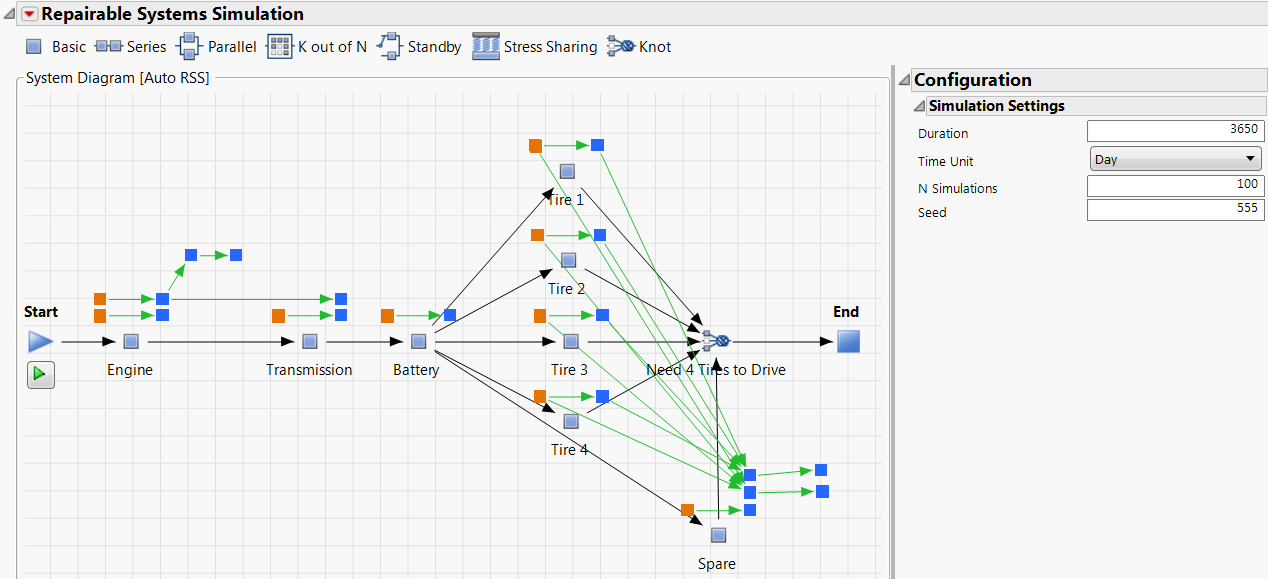

Figure 13.2 Car Repair System Diagram
An RSS window that diagrams a car system appears. In the diagram, the first block on the left is the Start block. Notice in the Configuration panel, on the right side of the RSS window, that the simulation is set to run for 3650 days.
2. (Optional) Enter 555 next to Seed.
Because the simulation involves random component failures, this action ensures that you obtain the exact results shown below.
3. Click the green triangle below the Start block to simulate the car system.

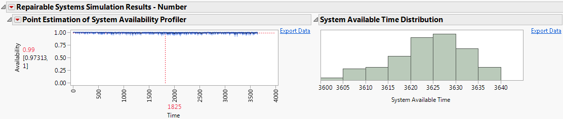

A window appears containing the Repairable Systems Simulation Results report. For more information about how to interpret these results, see Simulation Results Table.
Figure 13.3 Partial RSS Report
Partial RSS Report
You predict that the car will be available between 3,600 and 3,640 days over the next 10 years. Because the values shown in the Point Estimation of System Availability graph are close to one, you conclude that the car will be mostly available to drive over the next 10 years. You are interested in which components cause the most downtime for the system.

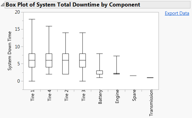

5. Click the red triangle next to Repairable Systems Simulation Results - Number and select Box Plot of System Total Downtime by Component.
Figure 13.4 Partial Box Plot of System Total Downtime by Component Report
You conclude that the tires cause the most downtime for the car system. To increase the average total system availability, you might consider using more durable tires or carrying another spare tire.
