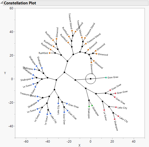

Figure 13.1 Example of a Constellation Plot
