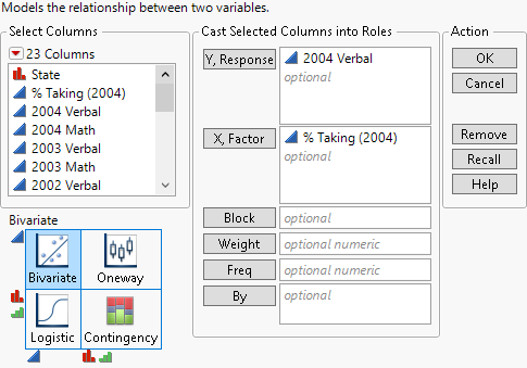

Launch the Bivariate platform by selecting Analyze > Fit Y by X. The Fit Y by X launch window is used for four different types of analyses. When you enter a continuous Y variable and a continuous X variable, the Bivariate platform is launched.
Figure 5.3 The Bivariate Launch Window

Y, Response
The response variable or variables that you want to analyze. The response variable is often called the dependent variable. These variables must have a continuous modeling type.
X, Factor
The predictor variable or variables that you want to analyze. The factor variables are often called independent variables. These variables must have a continuous modeling type.
Block
(Not applicable for a bivariate analysis.) A column that specifies a Blocking variable.
Weight
A column containing a weight for each observation in the data table. A row is included in the analyses only when its value is greater than zero.
Freq
Assigns a frequency to each row in the analysis. Assigning a frequency is useful when your data are summarized.
