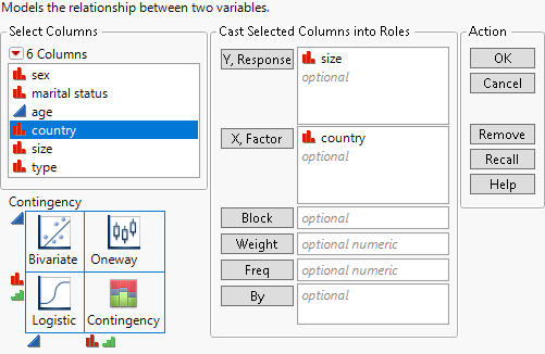

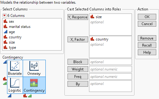

Launch the Contingency platform by selecting Analyze > Fit Y by X. The Fit Y by X launch window is used for four different types of analyses. When you enter an ordinal or nominal Y variable and an ordinal or nominal X variable, the Contingency platform is launched.
Figure 7.3 The Contingency Launch Window
