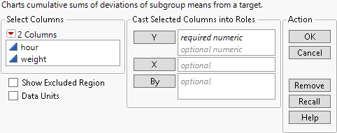

Figure 10.4 The CUSUM Control Chart Launch Window
The CUSUM Control Chart platform launch window contains the following options:
