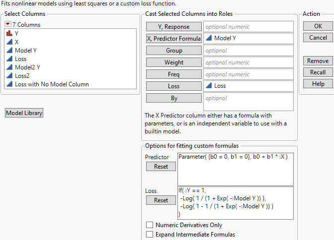

Launch the Nonlinear Platform
To launch the Nonlinear platform, select Analyze > Specialized Modeling > Nonlinear.
Figure 15.5 Nonlinear Platform Launch Window
The Nonlinear platform launch window has the following features:
Y, Response
Select the Y variable.
X, Predictor Formula
Select either the X variable or a column containing the model formula with parameters.
Note: If you select a column that does not contain a model formula with parameters and you also do not specify a custom formula, the Fit Curve platform is launched instead.
Note: If you select a formula column that contains a parameter list item that does not have an assignment, JMP automatically sets that parameter to zero and displays a message in the log.
Group
Specify a grouping variable. The fitted model has separate parameters for each level of the grouping variable. This enables you to compare fitted models and estimated parameters across the levels of the grouping variable.
Note: If the formula does not have separate parameters for each group level, the Group variable is ignored by JMP.
Weight
Specify a variable containing the weights of observations.
Freq
Specify a variable representing the frequency of an observation.
Loss
Specify a formula column giving a loss function.
By
Specify a variable to perform a separate analysis for every level of the variable.
Model Library
Launches the Model Library tool, which helps you choose initial values to create a formula column. See Create a Formula Using the Model Library.
Options for fitting custom formulas
If you specify a column in the X, Predictor Formula role that does not contain a model formula with parameters, you can use this option to create a custom formula. In the Predictor field, specify parameters, parameter values, and a custom formula that uses the selected X variable. Then, click the Reset button and launch the platform.
Numeric Derivatives Only
Uses numeric derivatives only. This option is useful when you have a model for which it is too messy to take analytic derivatives. It can also be valuable in obtaining convergence in tough cases. This option is used only when a formula column is provided in the X, Predictor Formula role.
Expand Intermediate Formulas
Tells JMP that if an ingredient column to the model is a column that itself has a formula, to substitute the inner formula, as long as it refers to other columns. To prevent an ingredient column from expanding, use the Other column property with a name of “Expand Formula” and a value of 0. This option is used only when a formula column is provided in the X, Predictor Formula role.
