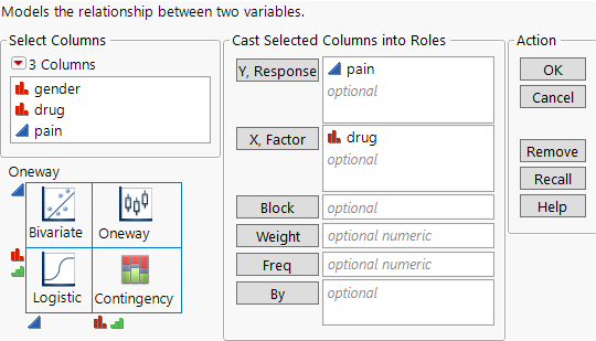

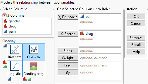

Launch the Oneway platform by selecting Analyze > Fit Y by X. The Fit Y by X launch window is used for four different types of analyses. When you enter a continuous Y variable and a categorical nominal or ordinal X variable, the Oneway platform is launched. A report for each combination of X and Y variables is launched.
Figure 6.4 The Oneway Launch Window
For more information about the options in the Select Columns red triangle menu, see Column Filter Menu in Using JMP. The Oneway launch window contains the following options:
Y, Response
The response variable or variables that you want to analyze. These variables must have a numeric data type.
X, Factor
The predictor variable or variables that you want to analyze. These variables must have a nominal or ordinal data type.
Block
A column that specifies a Blocking variable. When used, the values of the Y variable are centered by the Block variable. If there are equal counts in each block by group cell, the available Oneway platform options are for a two-way analysis. If there are unequal counts in the block by group cells, a one-way ANOVA with blocking model is fit and no Oneway platform options are available.
Weight
A column containing a weight for each observation in the data table. A row is included in the analyses only when its value is greater than zero.
Freq
Assigns a frequency to each row in the analysis. Assigning a frequency is useful when your data are summarized.
By
