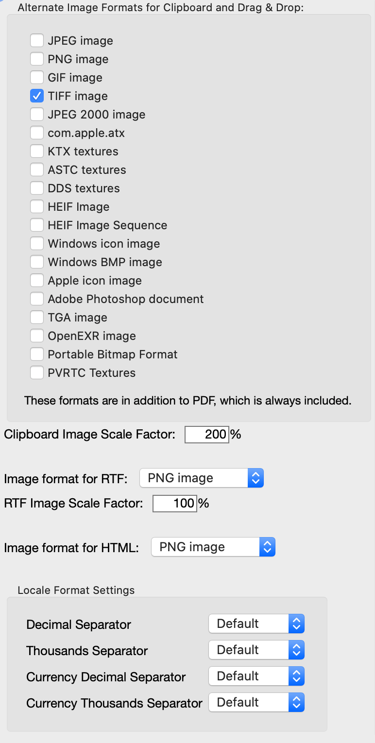

Mac OS Settings preferences customize settings for macOS machines, including the graphics formats and file associations.
Figure 14.23 Mac OS Settings Preferences
Table 14.22 Preferences on the Mac OS Settings Page
Preference
Description
Alternate Image Formats for Clipboard and Drag & Drop
Select one or more graphic formats to use when copying and pasting (or dragging and dropping) graphics from JMP into other applications. The default setting is TIFF.
Clipboard Image Scale Factor
Enter the percentage at which you want graphics to appear in other applications. The default setting is 200%.
Image format for RTF
Select the format to use for graphics when you save a JMP report as an RTF file. The default setting is PNG.
RTF Image Scale Factor
Enter the percentage at which you want graphics to appear in RTF documents. The default setting is 100%.
Image format for HTML
Select the format to use for graphics when you save a JMP report as an HTML file. The default setting is PNG.
Locale Format Settings
Specify the decimal and thousands separators used for numbers and currency values. The Default setting uses the system locale. If a non-default setting is specified, that setting overrides the system locale.
