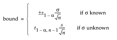

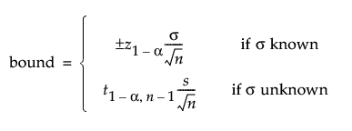

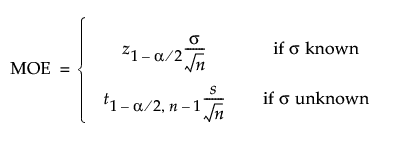

Confidence Intervals
The margin of error (MOE) for confidence intervals is calculated as follows:
Equation shown here
The bound is calculated as follows:
Equation shown here

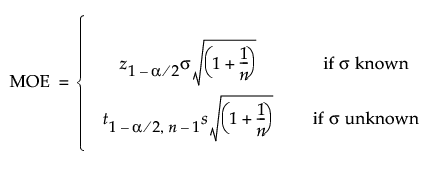

Prediction Intervals
The margin of error (MOE) for prediction intervals is calculated as follows:
Equation shown here

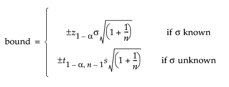

Equation shown here

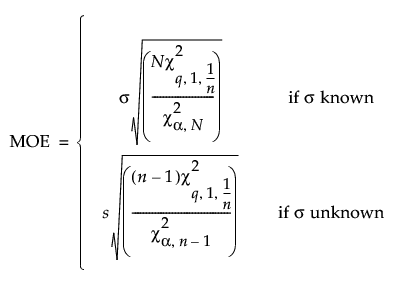

Tolerance Intervals
For the tolerance interval on a proportion q of the population, the margin of error or bound is computed based on approximate procedures described in Krishnamoorthy and Mathew (2009).
The margin of error (MOE) for tolerance intervals is calculated as follows:
