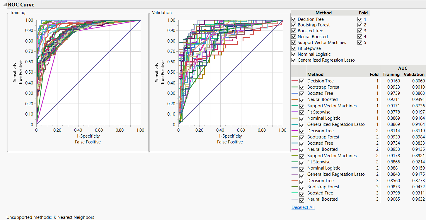

The Model Screening platform in JMP Pro enables you to run multiple predictive modeling platforms from one launch window and assemble summaries from the different methods. This helps you pick the best performing model without launching each individual model platform. You can also easily launch an individual platform report for any of the models from the Model Screening report window for further refinement.
Figure 10.1 Model Screening Report
