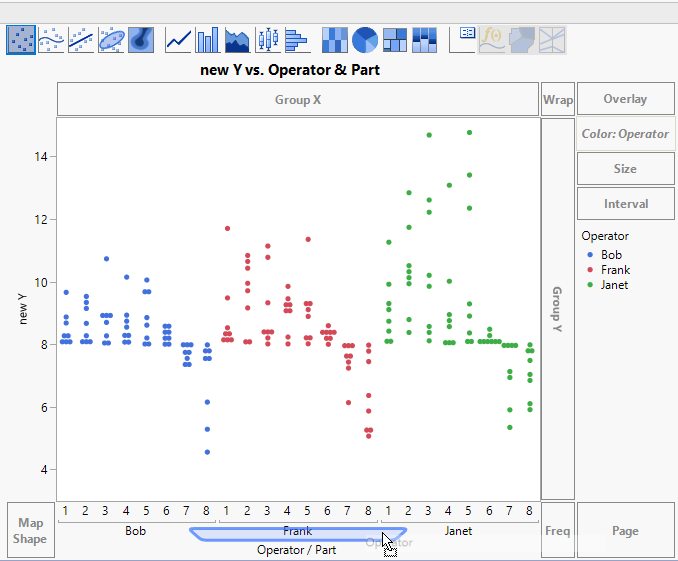

6. Select Operator and drag it beneath Part in the X zone.
The label Operator/Part appears, indicating that Part is associated with the topmost axis, and Operator is associated with the lower axis.
Figure 3.16 Drag Operator to Add a Second Axis
Now it is easier to see that Janet tends to obtain higher measurements for the same parts than do Bob and Frank. But what about the effect of Instrument?

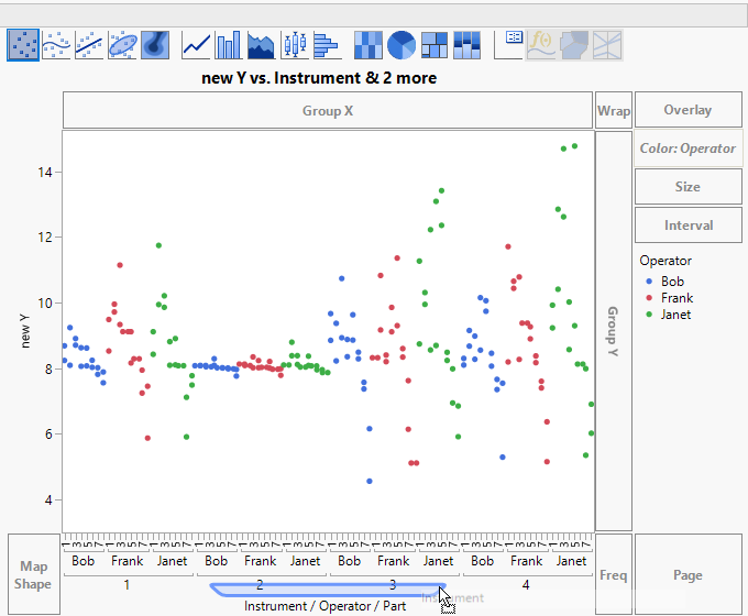

7. Select Instrument and drag it beneath Operator/Part in the X zone.
The label Instrument/Operator/Part appears, indicating that a third axis for Instrument has been added beneath the Operator axis.
Figure 3.17 Drag Instrument to Add a Third Axis
It is clear that Instrument 2 leads to much more consistent measurements than the other three instruments. For Instrument 2, there is comparatively little variation between or within operators.

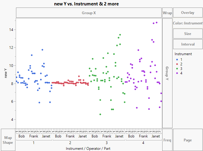

8. Select Instrument and drag it to the Color zone.
Figure 3.18 Three Nested Axes
Three Nested Axes
Now the new Y values are colored by Instrument, and it is easy to see Instrument differences.
By nesting the axes for the three factors in study, you are able to obtain a visual understanding of the variation attributable to the factors.
