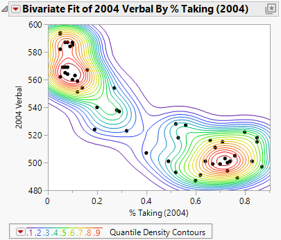

In the Bivariate platform, use the Nonpar Density option to fit a smooth nonparametric bivariate surface to your data. The nonparametric density fit is visualized using a set of contours. The contours are in 5% intervals. This means that about 5% of the points generated from the estimated nonparametric distribution are within the innermost contour, 10% are within the next contour, and so on. The outermost contour contains about 95% of the points.
Figure 5.14 Example of Nonpar Density

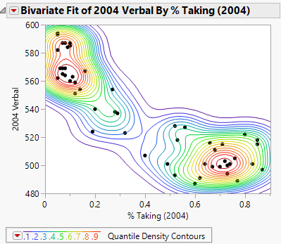

To change the size of a nonparametric density contour grid, press Shift and select Nonpar Density from the Bivariate red triangle menu. Enter a larger value than the default 102 points.

Kernel Std
The kernel band width. The initial value is based on the standard deviation of the variable. Adjust the slider to increase or decrease the density of the contours.
