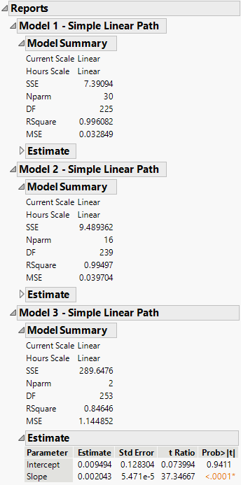

The Reports section of the Degradation Data Analysis report contains details about each model fit. The report includes a Model Summary report, and an Estimate report.
Figure 7.18 Model Reports
Model Reports
The Model Summary report contains the following information:
<Y, Response> Scale
The transformation on the response variable.
<Time> Scale
The transformation on the time variable.
SSE
The error sums-of-squares.
Nparm
The number of parameters estimated for the model.
DF
The error degrees of freedom.
RSquare
The R-square.
MSE
The mean square error.
The Estimate report contains the following information:
Parameter
The name of the parameter.
Estimate
The estimate of the parameter.
Std Error
The standard error of the parameter estimate.
t Ratio
The t statistic for the parameter, computed as the Estimate divided by the Std Error.
Prob>|t|
The p-value for a two-sided test for the parameter.
