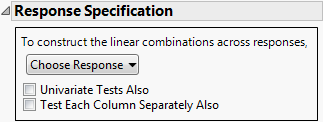

In the Manova Fit report, specify the response designs for various tests using the Response Specification panel.
Figure 10.4 Response Specification PanelĀ

Choose Response
Provides choices for response design, which forms the M matrix. The columns of an M matrix define a set of transformation variables for the multivariate analysis. You can choose among the following options for the M matrix:
