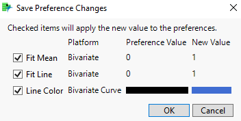

2. On the red triangle menu, select Platform Preferences > Save Changes to. A window similar to the following is displayed:
Figure 9.74 Save Preference ChangesĀ
3. Deselect any options that you do not want to save.
4. Click OK.
Your preferences have been updated with the new values. Preferences are usually only referenced when a platform starts (or reruns). If you made changes in the dialog, your new preferences may not be active until you rerun the platform.
