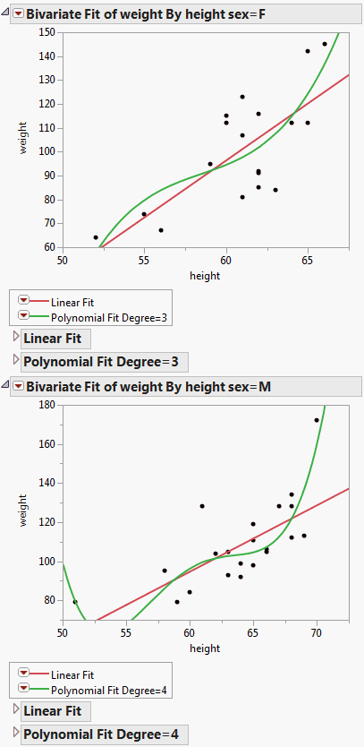

9. Highlight the line you just created and click Run Script Image shown here.
In the report window, a quartic fit line is added to the M graph, with the corresponding Polynomial Fit reports.
Figure 10.2 By Group ReportsĀ
By Group Reports
