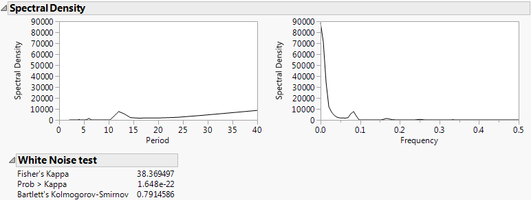

Spectral Density Report
The Spectral Density report in the Time Series platform contains two spectral density plots and a White Noise Test table.
Figure 18.15 Spectral Density Plots and White Noise Test Report
The White Noise Test table contains the following statistics:
