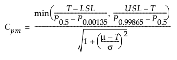

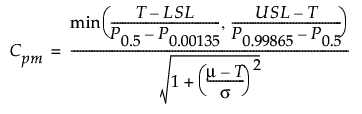

Percentile (ISO/Quantile) Method
The percentile method replaces the mean in the standard capability formulas with the median of the fitted distribution and the 6σ range of values with the corresponding percentile range. The method is described in AIAG (2005).
Denote the α*100th percentile of the fitted distribution by Pα. Then Percentile method capability indices are defined as follows:
Equation shown here
Equation shown here
Equation shown here
Equation shown here
Equation shown here
