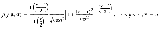

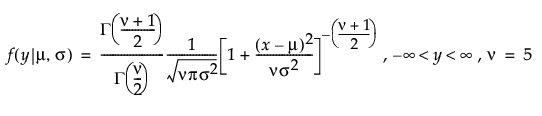

t(5) Distribution
Equation shown here
Equation shown here
Equation shown here

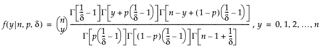

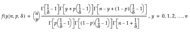

Beta Binomial Distribution
Equation shown here
Equation shown here
Equation shown here

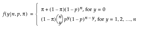

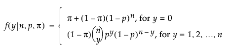

Zero-Inflated Binomial Distribution
Equation shown here
Equation shown here
Equation shown here

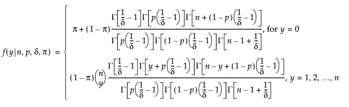

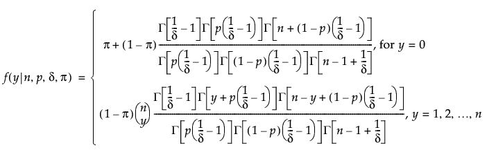

Zero-Inflated Beta Binomial Distribution
Equation shown here
Equation shown here
Equation shown here

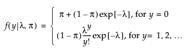

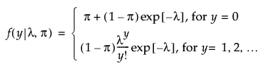

Zero-Inflated Poisson Distribution
Equation shown here
Equation shown here
Equation shown here

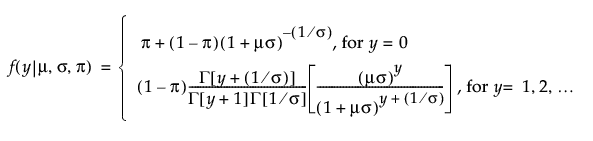

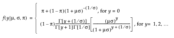

Zero-Inflated Negative Binomial Distribution
Equation shown here
Equation shown here
Equation shown here

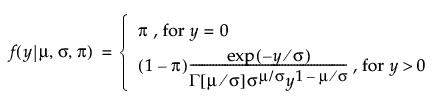

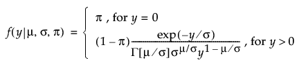

Zero-Inflated Gamma Distribution
Equation shown here
Equation shown here
Equation shown here
