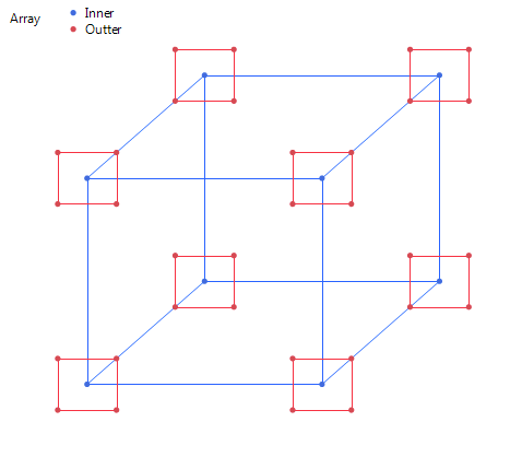

A Taguchi design uses crossed array to explore factors in the presence of noise. A Taguchi design has two parts: the inner array is a design for control factors, and the outer array is a design for the noise factors. The full design is the cross product of the two arrays.
Note that noise factors in production that are not easy or cost effective to control must be controlled during an experiment. Alternatives to Taguchi designs include combined arrays and mixed resolution designs (Borror and Montgomery, 2000). For an example of a design with noise factors using the Custom Design platform, see Experiments for Robust Process and Product Design.
Figure 15.1 Taguchi Design with Three Control Factors and Two Noise Factors
