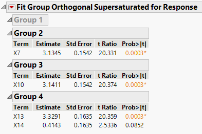

The Fit Group Orthogonal Supersaturated Report has two sections. The first section reports the estimates of active effects within each group, fitting one group at a time. Only active groups are shown. This is Stage 1 of the analysis. In Stage 2 a combined model is constructed
Figure 28.5 Stage 1 FindingsĀ
Stage 1 Findings
Term
Main effects that are identified as active.
Estimate
Parameter estimate for a regression fit of Y on the main effect.
Std Error
The standard error of the estimate, computed using the fake factors in Group 1.
t Ratio
The Estimate divided by its Std Error.
Prob>|t|
The p-value computed using the t Ratio and the degrees of freedom for error (DF).

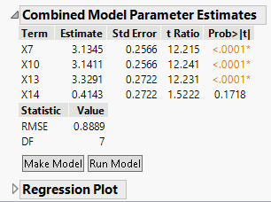

The second section of the report contains the results of Stage 2 of the analysis. Stage 2 constructs the model used to evaluate the design results.
Figure 28.6 Stage 2 ResultsĀ
Stage 2 Results
Term
Estimate
Std Error
The standard error of the estimates obtained by fitting the specified model and intercept using the full data set.
t Ratio
Prob>|t|
RMSE
The square root of the mean square error.
DF
The degrees of freedom associated with the error estimate used to construct the RMSE.
