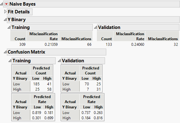

Image shown hereThe Naive Bayes Report
By default, the Naive Bayes report contains reports for fit details, the response column, the Confusion Matrix report, and the ROC and Lift curves.
Figure 8.7 Naive Bayes ReportĀ
Naive Bayes Report

Image shown hereResponse Column Report
In the Naive Bayes platform, the report for the response column is named after the column name of the response. The report shows performance statistics for the naive Bayes classification in a summary table for the Training set, and the Validation and Test sets if they are specified. The summary tables contain the following columns:

Image shown hereConfusion Matrix Report
The Confusion Matrix report in the Naive Bayes platform shows a confusion matrix and a confusion rates matrix for the Training set, and for the Validation and Test sets if they are specified. A confusion matrix is a two-way classification of actual and predicted responses. A confusion rates matrix is equal to the confusion matrix, with the numbers divided by the row totals.
