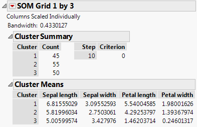

The Cluster Comparison report appears at the top of the report window. The best fit is determined by the highest CCC value. Notice the number of clusters that gives the largest CCC is 3, which is the number of species.
14. Scroll to the SOM Grid 1 by 3 report. We can see the classification was not perfect; each cluster should represent each species, with 50 rows for each.
Figure 14.11 Self-Organizing Map Report for Iris.jmp

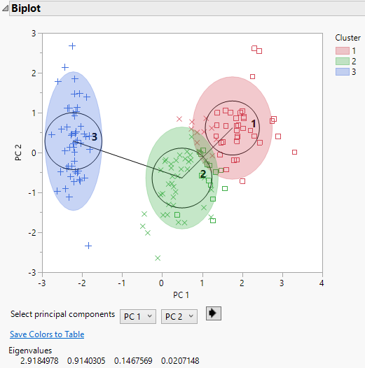

18. Click the red triangle menu next to SOM Grid 1 by 3 and select Biplot.
19. Click the red triangle menu next to SOM Grid 1 by 3 and select Biplot Options > Show Biplot Rays.
Figure 14.12 SOM Biplot
SOM Biplot
We can see that all rows from Cluster 3 are correctly identified as the setosa species. The other two species, virginica and versicolor, overlap slightly and can be mistaken for each other.
