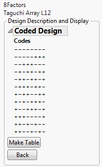

Figure 15.10 Coding for Eight Factor L12 Design
The Coded Design shows the pattern of high and low values for the factors in each run.
