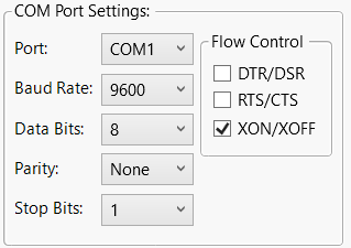

(Windows only) Communications preferences customize settings for reading data from an external source. These settings need to be specified only if you are using an instrument to do so.
Figure 14.24 Communications Preferences
Table 14.23 Preferences on the Communications Page
Preference
Description
Port
Select the port that your data source uses.
Baud Rate
Set the baud rate for your data source.
Data Bits
Set the number of data bits (7 or 8).
Parity
Set the parity bit. None is the default setting.
Stop Bits
Set the stop bits (1 or 2).
Flow Control
Set the flow control. XON/XOFF is the default setting.
