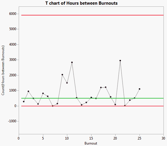

In this example, you use the interactive workspace in Control Chart Builder to create a T chart to explore data from a fan manufacturing process. The first column identifies each fan that burned out. The second column identifies the number of hours between each burnout.
T charts are used to measure the time that has elapsed since the last event. See Rare Event Control Charts.

5. In the drop-down list, select Rare Event instead of Shewhart Variables.
6. Under Limits, change the Sigma from Negative Binomial to Weibull.
Figure 3.33 T chart of Hours Between Burnouts
In the T chart, all points appear to be within the control limits. It is clear that the Individual & Moving Range chart was inappropriate for the analysis, as the limits were too narrow.
