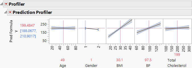

Figure 3.39 Profiler with Confidence Intervals
A prediction profiler with confidence intervals constructed using the standard error of the predicted values is shown.
