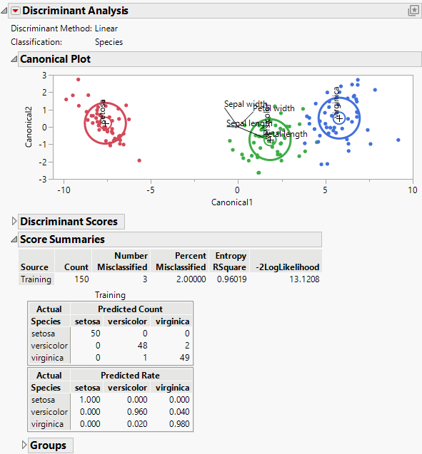

Figure 5.2 Discriminant Analysis Report Window
Because there are three classes for Species, there are two canonical variables. In the Canonical Plot, each observation is plotted against the two canonical coordinates. The plot shows that these two coordinates separate the three species. Since there was no validation set, the Score Summaries report shows a panel for the Training set only. When there is no validation set, the entire data set is considered the Training set. Of the 150 observations, only three are misclassified.
