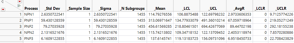

6. Click the Control Chart Builder red triangle and select Save Limits > in New Tall Table.
Figure 3.35 New Tall TableĀ
New Tall Table
The control limits are saved to a new data table, with a row for each Y variable and a column for each statistic.
