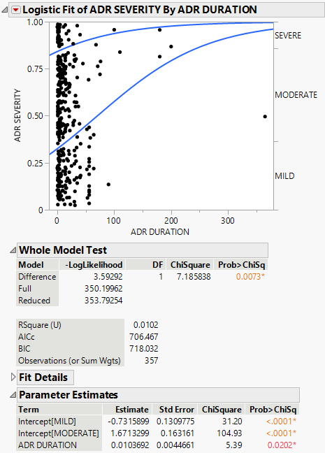

Figure 8.5 Example of Ordinal Logistic ReportĀ
In the plot, markers for the data are drawn at their X coordinate value along the horizontal axis and at a random vertical position below the curve for their Y value.
For more information about the Whole Model Test report and the Parameter Estimates report, see The Logistic Report. In the Parameter Estimates report, an intercept parameter is estimated for every response level except the last, but there is only one slope parameter. The intercept parameters show the spacing of the response levels. They always increase monotonically.
