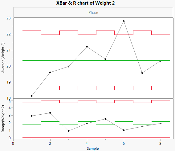

3. Drag Weight 2 to the Y role.
4. Drag Sample to the Subgroup role (at bottom).
Figure 3.20 XBar and R Charts for Varying Subgroup SizesĀ
Weight 2 has several missing values in the data, so the chart has uneven limits. Although each sample has the same number of observations, samples 1, 3, 5, and 7 each have a missing value.

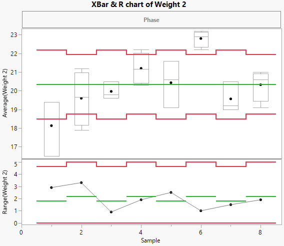

Instead of viewing a line connecting the averages of each sample, you can switch to viewing box plots at each sample.
5. In the Points[1] outline, deselect the Show Connect Line option.
6. In the Points[1] outline, select the Box Plots option.
Figure 3.21 XBar and R Chart with Box PlotsĀ
