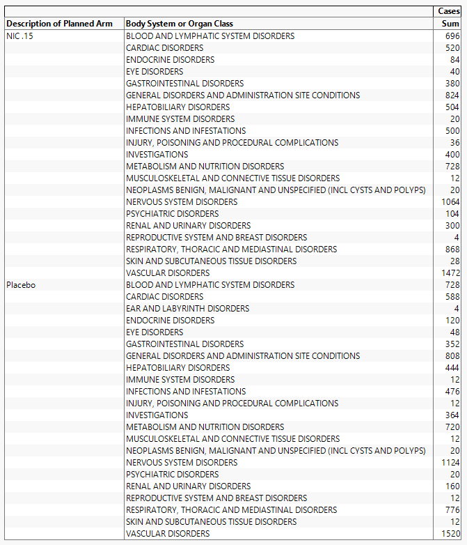

At this point, the table contains the number of adverse events in each body system or organ class, grouped by drug versus placebo. However, you are interested in the number of unique patients that had an adverse event in each body system or organ class.
6. Select Unique Subject Identifier and drag it to the ID column role.
7. Click Done.
Figure 9.26 Tabulate Report with a Unique ID ColumnĀ
The table shows the number of patients who experienced an adverse event in each body system or organ class for either the drug or the placebo treatment. For instance, there were 696 patients that were given the drug treatment and reported at least one adverse event in the blood and lymphatic system.
