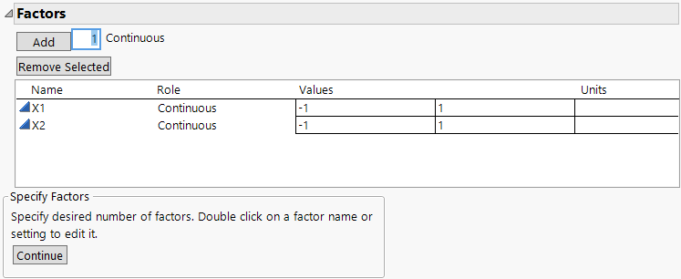

The initial Factors panel for a response surface design appears with two continuous factors.

The factors section contains the following buttons.
Add
Enters the number of continuous factors specified.
Remove Selected
Removes the selected factors.
Tip: When you have completed your Factors panel, select Save Factors from the red triangle menu. This saves the factor names and values in a data table that you can later reload. See Response Surface Design Options.
The Factors section contains the following columns:
Name
The name of the factor. When added, a factor is given a default name of X1, X2, and so on. To change this name, double-click it and enter the desired name.
Role
Specifies the Design Role of the factor as Continuous. The Design Role column property for the factor is saved to the data table. This property ensures that the factor type is modeled appropriately.
Values
The experimental settings for the factors. To insert Values, click the default values and enter the desired values.
Units
The experimental units for the factor. To insert Units, click and enter the desired values.
