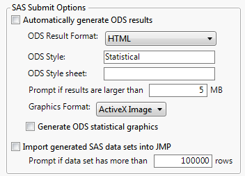

2. Open the SAS Integration category and find the large SAS Submit Options group.
Figure 3.64 SAS Submit Options in Preferences
3. Select the Automatically generate ODS results option.
4. From the ODS Result Format list, select the format in which to generate the ODS results: HTML, PDF, RTF, or a JMP report.
5. (Optional) You can use other options to specify a style or style sheet to format the results or set the format for generated graphics. See Preferences for Updating JMP.
