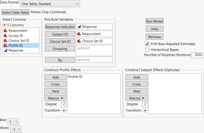

Launch the MaxDiff platform by selecting Analyze > Consumer Research > MaxDiff. If your MaxDiff data is in a single table, select One Table, Stacked from the Data Format menu.
Figure 5.9 Launch Window for One Table, Stacked Data FormatĀ
