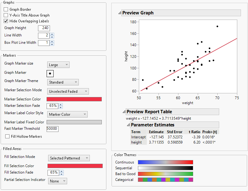

Graph preferences customize the appearance of graphs. See Preferences for Data Tables for more information about configuring the appearance of graphs.
Figure 14.3 Graphs Preferences
Graphs Preferences
Table 14.3 Preferences on the Graphs Page

Graph Border
Draws a border line around the area of the graph. This option is deselected by default.
Y-Axis Title Above Graph
Shows the Title for the Y-Axis above the line rather than beside the line. This option is deselected by default.
Hide Overlapping Labels
Select this option to hide overlapping chart labels. This option is selected by default.
Graph Height
Sets the default height (in pixels) for a graph. The default setting is 240 pixels. Some platforms take the value and multiply it by a certain amount.
Note: With Graph Builder windows, specifying the Graph Height enlarges the window proportionally, but the exact value is not applied.
Line Width
Sets the default width (in pixels) for lines that pertain to content. The default setting is two pixels.
Note: This preference does not apply to grid lines.
Box Plot Line Width
Sets the default line width for box plots across platforms.
Graph Marker Size
Select a default size for the markers in graphs: Dot, Small, Medium, Large, XL, XXL, or XXXL. This preference is applied when the marker size is set to Preferred on a graph. The default setting is Large.
When the number of markers in a graph exceeds the Fast Marker Threshold, the graph’s Marker Drawing Mode is set to Fast. which draws dot-sized markers.
Graph Marker
Select a default marker shape for the markers in graphs. The default setting is a small dot.
Graph Marker Theme
Select a default theme for the markers in graphs when you mark by row or column. The default setting is Standard.
Marker Selection Mode
Select the default formatting for selected markers. The default setting is Unselected Faded. See Change the Selection Mode of Markers.
Marker Selection Color
When the Marker Selection Mode is Selected Same Color, this setting applies the specified color to selected markers. The default color is Red.
Marker Selection Fade
When the Marker Selection Mode is Unselected Faded, this setting fades the unselected markers by the specified amount (in percent). The default setting is 65%.
Marker Label Color Style
Select the color of the marker label that appears on a graph when you label a column in the data table.
Marker Color
The marker label is the same color as the marker. This option is selected by default.
Marker Color Faded
The marker label is faded according to the Marker Selection Fade preference.
Fixed Color
The marker label color is as specified. The Marker Label Fixed Color preference determines the color.
Select the color of fixed-color marker labels, an option that you select in the Marker Label Color Style preference. The default color is gray.
When JMP refreshes a report window, it can draw markers or points on a plot at two different speeds: normal and fast. If JMP is in normal drawing mode, and the number of markers on a graph are more than the specified threshold number, JMP automatically switches to fast mode.
Enter the number of markers that separate normal and fast mode. When the number of markers in a graph exceeds the Fast Marker Threshold, the graph's Marker Drawing Mode is set to Fast. which draws dot-sized markers. The default setting is 50,000.
Fill Hollow Markers
Select this option to apply an opaque background to markers. This option is deselected by default.
Fill Selection Mode
Select the default highlight for selected rows in graphic objects:
Selected Patterned
A striped pattern (default)
Selected Darkened
A solid darker color
Selected Outlined
An outline
Selected Same Color
The Fill Selection Color in the preferences formats the selected object.
Unselected Faded
Unselected rows are faded, and selected rows are the original color.
Select the default color of selected rows in graphic objects when the Fill Selection Mode is “Selected Same Color”. The default color is red.
Fill Selection Fade
This setting fades the unselected markers by the specified amount (in percent). The default setting is 65%.
Partial Selection Indicator
Select the indicator for a partial selection. The available options are None, Bar, Pie, or Waffle. The default setting is None.
Continuous Color Theme
Select a default color theme for continuous data. The default theme is Blue to Gray to Red. See Create Color Themes in Graphs.
Sequential Color Theme
Select the default color theme for sequential data that do not have a meaningful midpoint. The default theme is White to Black.
Bad to Good Color Theme
Select the default color theme for diverging data that ranges from positive to negative data. The default theme is Stoplight Bad to Good.
Categorical Color Theme
Select a default color theme for categorical data. The default theme is JMP Default. See Create Color Themes in Graphs.
