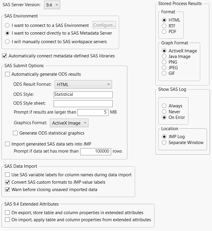

Figure 14.16 SAS Integration Preferences
Table 14.15 Preferences on the SAS Integration Page
Preference
Description
SAS Server Version
Select the default version for the SAS Server. This can also be changed in the Server Connections window. (See Connect to a SAS Metadata Server from JMP.) This option does not apply when connecting to local SAS on Windows. The default setting is 9.4.
I want to connect to a SAS Environment
Select this option to always connect to a SAS Environment and click Configure to configure the URL of the location. This option is deselected by default.
I want to connect to a SAS Metadata Server
Select this option to always connect to a SAS Metadata Server. This option is selected by default.
Clear this option if you do not have a SAS Metadata Server available, and you connect directly to SAS Workspace Servers instead.
I will manually connect to SAS workspace servers
Select this option to manually connect to a SAS workspace server. This option is deselected by default.
Automatically connect metadata-defined SAS libraries
Select this option to connect to metadata-defined SAS libraries automatically across all JMP sessions when you connect to a SAS Workspace Server. his option is selected by default.
When the Workspace Server contains a large number of metadata-defined SAS libraries, deselect this option to speed up your connection to the server.
Automatically generate ODS results
Select this option to generate output delivery system (ODS) results. This option is deselected by default.
ODS Result Format
Select the format for ODS reports. The default setting is HTML.
ODS Style
Enter the style name for ODS reports. The default setting is Statistical.
ODS Style sheet
Enter the style sheet name for ODS reports.
Prompt if results are larger than __ MB
Enter the number of MB that triggers a prompt for you to continue or cancel the operation. Five is the default setting.
Graphics Format
Select the format for graphics for ODS reports. ActiveX Image is the default setting.
Generate ODS statistical graphics
Select this option to include statistical graphics in the ODS reports.
Import generated SAS data sets into JMP
Select this option to import any generated data sets into JMP automatically.
Prompt if data set has more than __ rows
Enter the number of rows that triggers a prompt for you to continue or cancel the operation. The default setting is 100,000.
Use SAS variable labels for column names during data import
Select this option to use the column labels in the SAS data set as the JMP data table column names when importing a SAS data set into a JMP data table. This option is deselected by default.
Convert SAS custom formats to JMP value labels
Select this option to use the information in the SAS column formats to set JMP value labels when importing a SAS data set into a JMP data table. This option is selected by default.
Warn before closing unsaved imported data
Select this option to trigger a prompt to save any SAS data sets that you imported into JMP and have not saved before closing. This option is selected by default.
On export, store table and column properties in extended attributes
Select to allow extended attribute support during SAS 9.4 data export. This option is deselected by default.
On import, apply table and column properties from extended attributes
Select to allow extended attribute support during SAS 9.4 data import. This option is deselected by default.
Stored Process Results: Format
Select a report format: HTML (default), RTF, or PDF.
Stored Process Results: Graph Format
Select a graph format: ActiveX Image (default, available only on a SAS server that runs on Windows), Java Image, PNG, JPEG, or GIF.
Show SAS Log
Select Always, Never, or On Error (default) to set when the SAS log is displayed
Location
Select the location for SAS log information: within the JMP log window, or in a separate SAS log window. The default setting is the JMP log window.
