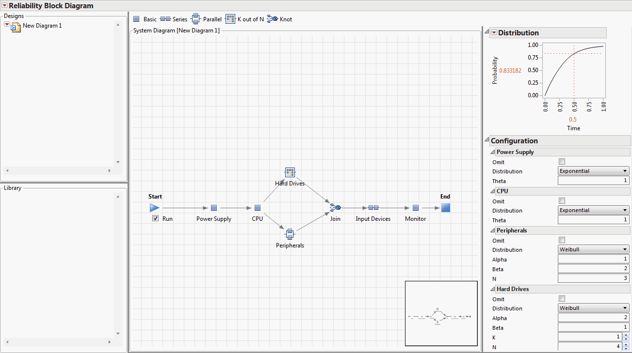

The Reliability Block Diagram platform shows the reliability relationships among a system's components. A reliability block diagram, also known as a dependence diagram, illustrates how component reliability contributes to the success or failure of a system. If reliability distributions are assigned to the components, the platform analytically models the reliability behavior.
Figure 12.1 Example of a Reliability Block DiagramĀ
