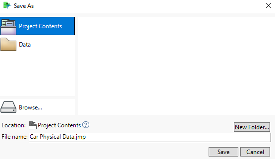

1. (Optional) To save the project as a self-contained project, save each data table and script in the project by selecting File > Save As and then select Project Contents. You can click New Folder to create a folder in the project contents.
Note: You do not need to save reports as these are automatically saved to the project.
Figure 10.24 Save a Data Table to the Project ContentsĀ

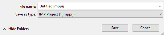

2. Select File > Save Project to save the project file.
Figure 10.25 Save a Project FileĀ
Save a Project File
