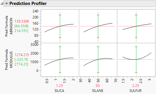

Figure 3.43 Green Propagation of Errors Bars in the Prediction Profiler
The POE is represented in the graph by a green bracket. The bracket indicates the prediction plus or minus three times the square root of the POE variance. The POE variance can be expressed as follows:
Equation shown here
where σy is the user-specified sigma for the response column, and σx is the user-specified sigma for the factor column.
